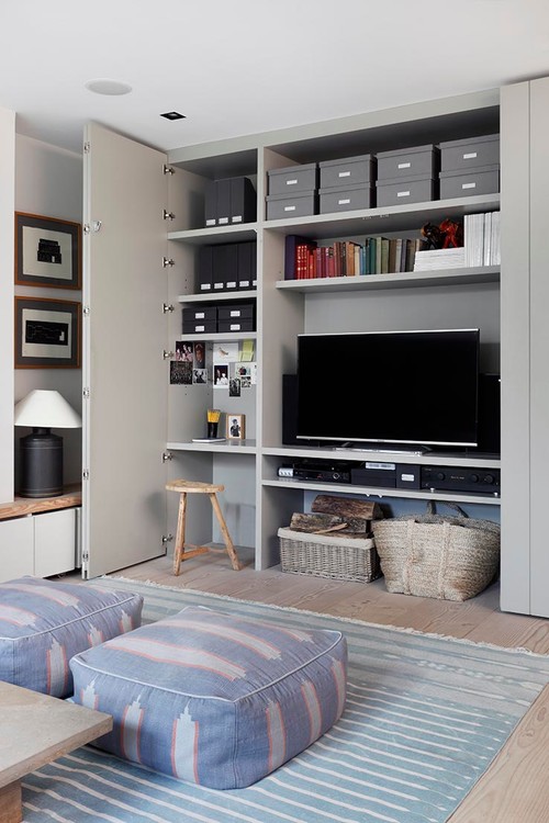

My concern is your square room. It cost me dearly to realise just how much influence room shape has on the tonal response. I was aware of acoustics but didn't think it would have such an impact as it did. I'd had an extension built to the workshop, but I'd lost one foot off the width due to the construction method I'd asked for. The extension was to be my office where amongst other things, I could audition my work. I could not audition a thing! The almost equal height to width caused boom. My posh new office ended up being workshop space, and the workshop got partitioned off to become my office. Being a foot wider with the ceiling height six inches lower solved the boom problem. I used the Amroc calculator to find where to place the partition wall, which gave a room ratio that fitted the "Bolt" area and the "Bonello" response. I went considerably further than most would do to absorb the room mode pressure zones using BBC absorber homemade clones. The room modes are still audible but not as prominent.
There is little that can be done in a domestic situation, and I'm not suggesting you go to the extremes I had to go to. However, if your aim is for good sound, which I think it is, I would seriously look at ways to improve your acoustics. I would be thinking about losing three feet off one floor area dimension - perhaps by fitting something like this?
If you can't, then I'd go for a bass reflex whose port resonates anywhere but the strong frequencies shown on the calculator, somewhere between 70 and 90 Hz.
Thanks, Graham. I don’t have much flexibility to change room dimensions, so it seems I will have to try to audition a selection in the space I have, and then choose..... There might be an option that I can explore.... What would be your opinion if the room was 18’ x 13’6” x 10’ high, with the speakers along the long wall?

  I run Accession MC direct to Proprius to drive a pair of PMC Twenty5.22. It’s fabulous! I agree with Graham about the square room, I’m sorry - just a month ago a I moved from a 6m x 6m room to a 8m x 5m rectangle. Holy cow! My system sounds a great deal better in every way.
A friend built a false wall in a square room (made it a storage space) so as to have a rectangle for his hifi and it looks great. Cheaper I suspect than upgrading components or speakers to achieve the same improvement.

Much better!
With speakers set apart 7 feet you can afford them to be 3 feet out into the room, and you would be 3 foot 6 away from the 'back wall'. Just try and keep it symmetrical.
