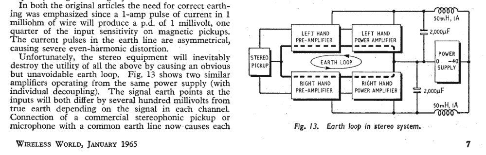

With no load, the amps should sit there quite happily, and they'll drive down to 4 ohms, so anything in-between should be OK. If they do otherwise, then I'll have failed as a designer, and I'll have to pay for their repair and issue instructions not to do it in future, but my guess is they'll be fine.
As for connecting the grounds of two mono amplifiers, as required to connect headphones, which have a common return - well, it can cause stereo distortion. Stereo ground loop distortion is mainly unknown. You might expect things like that would be important, especially for stereo... and multichannel stuff, but closed minds seem to exist in the magical world of hi-fi.
As John informs me, you will use 300-ohm phones; the current trying to go both ways is far less than you'd have on speakers - nearer to valve amplifier current, and stereo ground loop distortion was only discovered with the arrival of transistors - so might go completely unnoticed.
One might ask if there's a spec for stereo ground loop distortion, and the answer is no, and because of that, it can't exist.
Also, the star earth (discovered by Decca) rendered it inoperable but did it because star earths make rail decoupling impossible unless decoupled to each leg of the star, which voids the star earth, causing stereo ground loop distortion.

After discussion with John C, because each monoblock has its own power supply, there is no guarantee that the negative terminal of each monoblock is at absolutely the same electrical potential. When there is a difference in potential, no matter how small, there is the possibility of DC offset or current flow between them or from one amp's + to the other amp's -, where Graham was talking about distortion being introduced. If impedance is quite high, it might not be audible.
If you don't mind cutting off the audio jack from the end of the headphone cable, which I believe is where the negative connections will usually join together, they can be separated from each other and connected to separate monoblocks. Not too much of a big deal if the headphone cable is removable and can be replaced with an official spare part.
Post Options Post Options   Thanks (0) Thanks(0)   Quote Graham Slee Quote  Post ReplyReply Direct Link To This Post Posted: 08 Jul 2021 at 7:04pm
Although this was a slightly different problem, the main point remains that grounds commoned at both input and output can result in a loop.
stereo-loop
