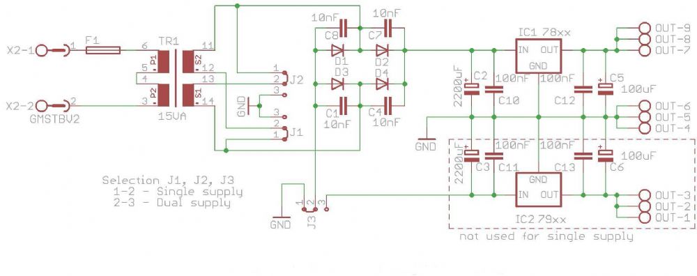

One of the jpegs I wanted to post was the PSU circuit diagram, which does include snubber caps.

PSU Schematic

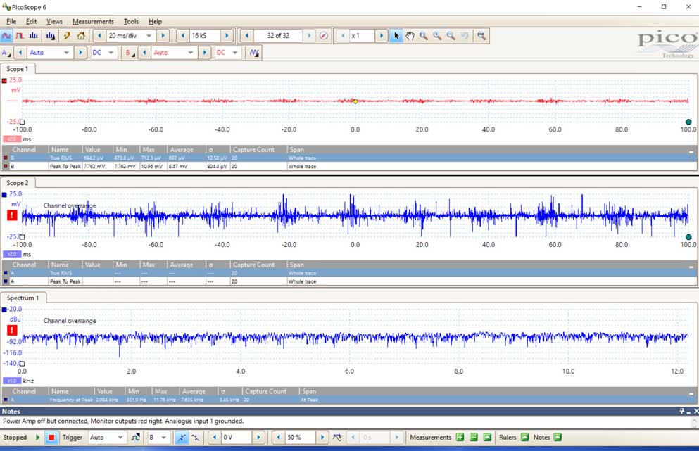

Scope snapshot of best case noise.
Red = Right channel, Blue = Left Channel, Spectrum of Left channel

Post Options Post Options   Thanks (0) Thanks(0)   Quote Richardl60 Quote  Post ReplyReply Direct Link To This Post Posted: 04 Mar 2017 at 6:14pm
Cannot comment on the technical side at all but my simple logic tellls me that if left/right channel differ it may not be mains related, either a feature of the electronic or cable dressing?
My mains feed is external on the outside of the house but another option may be under floorboards?

Post Options Post Options   Thanks (0) Thanks(0)   Quote peterb Quote  Post ReplyReply Direct Link To This Post Posted: 04 Mar 2017 at 6:15pm
Worst case, same colours, more sensitive voltage scale.

Post Options Post Options   Thanks (0) Thanks(0)   Quote peterb Quote  Post ReplyReply Direct Link To This Post Posted: 04 Mar 2017 at 6:34pm
I started with the same logic as you Richard but then the levels changed with no changes to the Pre ??
I might run a temporary spur from the consumer unit as a test, but not until the family are out for the day!
