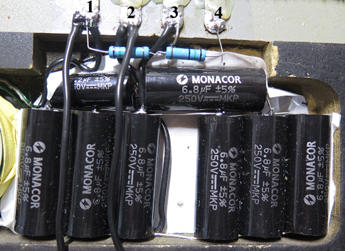

For completeness here is the right channel with the LF and HF wires in the same places.SMGa components with added resistor
I inserted 1 ohm resistance (actually two of 0.5 ohms)  in series with the HF as it was about 2dB louder than the left. You'll see that I just moved the inductor and input wires from tag 4 to tag 1 and fitted the resistors between those tags.
