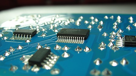

Post Options Post Options   Thanks (0) Thanks(0)   Quote Graham Slee Quote  Post ReplyReply Direct Link To This Post Posted: 24 Mar 2013 at 1:58pm
Like I said, I use a 2.4mm sloped tip. It looks similar to the one at the start of the video above.
For soldering component leads I rotate the iron so the flat is touching the lead and the reverse side is on the pad. This relies on good tinning/wetting of the iron's bit.
The video shows the use of leaded solder. I'm able to tell because it flows so easily. It also results in a gleaming shine.
I'm not allowed to use leaded solder and therefore it is much harder to get it to flow. What the guy shows in the video taking one sweep of the iron simply doesn't happen with unleaded.
Tin by itself becomes more brittle as it's heated and when molten it isn't very plastic. It needs aggressive fluxes in copious amounts to make it work.
Lead is a very plastic metal at all temperatures and the ideal 'mate' for tin.
Hence you can get 60/40 tin/lead solder which is great to work with.
