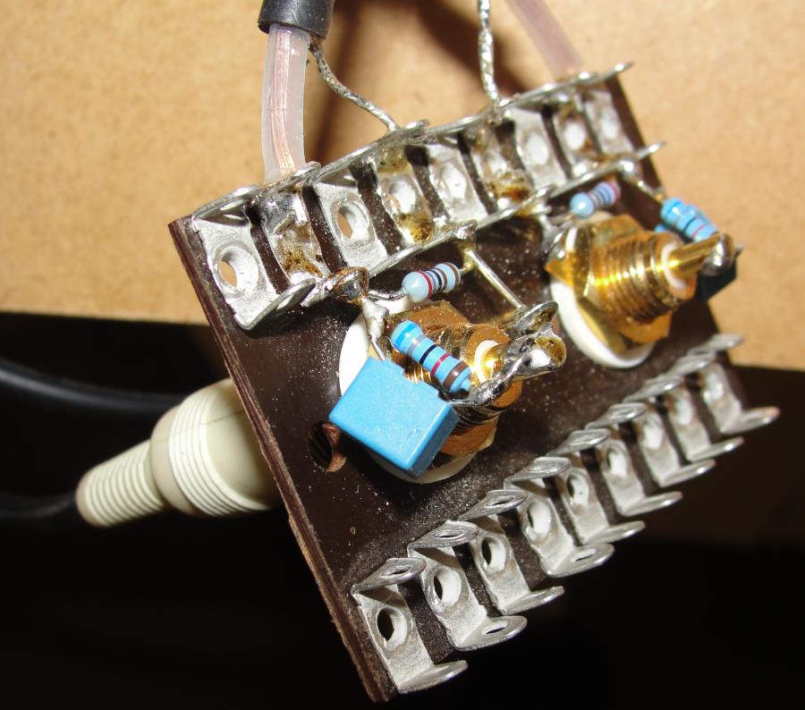

I've built the "Velocitone" on a piece of parallel tag strip, and I'll photograph it later so you can see how simple it is. It's all scrap box apart from the resistors and capacitors being new stock.

&quot;Velocitone&quot; circuit board

I ought to have used brand new phono sockets as the LHC kept cutting out. A goodly amount of "exercising it" seems to have made it make better contact, but there is obviously that lingering doubt. I will have to use a plastic box and machine it for the "PCB" type pressed metal sockets we use on products the next time. Some think them inferior, and the gold plated single screw on sockets superior, but I've got news for them...
The sound quality, i.e. tonal quality, improved with use. The bass became fuller. Just leaving it on won't improve it simply because it is a passive circuit. Current has to flow for a circuit of electronic components to age, and so it can only age through use.
