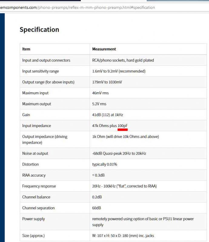

The Graham Reflex M has a fixed capacitance of 220 pF. It should work well with the Ortofon 2M. With the Sumiko it is a bit high.
Sumiko recommends a phono pre-amp with a maximum of 200 pF, so the Graham is a little bit over that. This may give the Sumiko a little lift in the treble.
Amp. Musical Fidelity M6si,Turntables VPI Scout Signature, Cartridges Ortofon Cadenza Bronze, Graham Slee Accession MC, Speakers Triangle Esprit Antal Ez, Cables Rotrwell The River,ATLAS Equator MKIII
Post Options Post Options   Thanks (0) Thanks(0)   Quote Graham Slee Quote  Post ReplyReply Direct Link To This Post Posted: 26 Mar 2020 at 11:31am
Depends on how old it is. Very early Reflex M's might have been 220pF, but since 2013 they are 100pF. See spec below.
Reflex M phono stage specification
