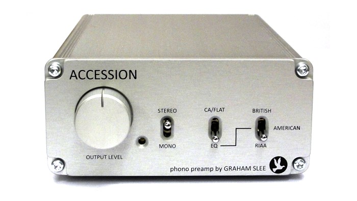

The Accession phono preamp is here...
Accession Phono Preamp
Output level control can act as volume control in a vinyl only system, but was intended to get the levels right into A-D converters.
There is also a fixed level ouput.
Stereo/mono switch is standard.
Three record EQ settings: RIAA; British (FFRR); American (NAB/NARTB).
Cartridge only EQ for those wanting to apply their own record EQ (CA/Flat). In this position the CV output of the cartridge is changed to CA (constant velocity to constant amplitude).

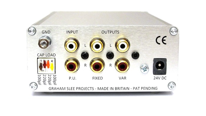

Accession Rear Panel
Below the usual turntable ground you will see additional capacitive loading: 100pf and 220pf for each channel.
Inputs and outputs are on gold plated 360 degree shielded phonos (RCAs).
The 24V DC socket accepts power from the PSU1.
All inputs EMC and ESD protected, including power.
Fully ground-planed board multi-point grounded to case - no more star earths!!!

That volume control will put an end to input clipping on ADCs when using a MM with a high output - I'm thinking specifically of the Goldring 1042 and similarly derived cartridges (DNM Reson Reca/Mica, Roksan derivatives etc).
 This may be able to connect into a crystal cartridge phono input... making the MM cartridge closely match the crystal cartridge output frequency curve... as was used in the 1960's in valve (tube) HiFi days.
 Graham has found that the crystal cartridge output was/is a constant amplitude (CA), and being non-magnetic, had no need for EQ of the magnetic properties of MM or MC cartridges.
Now he has an "Accession" phono preamp that can EQ the phono signal the same way it was done in the beginning!
The added features push this "over the top"!
Indeed Chris! This, combined with the EQ and loading settings should make this a winner! Thumbs Up
