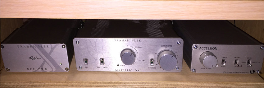

The Accession phono preamp is here...
Accession Phono Preamp
Output level control can act as volume control in a vinyl only system, but was intended to get the levels right into A-D converters.
There is also a fixed level ouput.
Stereo/mono switch is standard.
Three record EQ settings: RIAA; British (FFRR); American (NAB/NARTB).
Cartridge only EQ for those wanting to apply their own record EQ (CA/Flat). In this position the CV output of the cartridge is changed to CA (constant velocity to constant amplitude).
Accession Rear Panel
Below the usual turntable ground you will see additional capacitive loading: 100pf and 220pf for each channel.
Inputs and outputs are on gold plated 360 degree shielded phonos (RCAs).
The 24V DC socket accepts power from the PSU1.
All inputs EMC and ESD protected, including power.
Fully ground-planed board multi-point grounded to case - no more star earths!!!

"Fully ground-planed board multi-point grounded to case - no more star earths!!!"
I remember that my GSP designed Genera has star earths.  I've also seen other excellent phono stages and line amplifiers with ground planes.
Your thoughts on the pros and cons of the two grounding systems would be much appreciated.
Geoff
Date Posted: 08 Sep 2015 at 12:54am
I have seen use of star earths over the years and some rather weird ones that look a bit like 'spider plants' that make little sense and achieve even less.
The old proper way was to have a ground "Mecca" at the input "earth", and a good few pages were written in The Art of Electronics on the rights and wrongs - long before today's rise in RF gadgets.
It still left many unanswered questions especially in multiple input/output devices as where exactly the input earth should be placed. It was also very much trial and error in power distribution as I once found working into the night on a desk system for the "beeb": the system hummed when it shouldn't have. The team were getting rather hot under the collar, and the chief designer spotted the culprit...
I'd had the job of laying out the power supply board and the only way I could route the ground was from a rather thick track on the "input" side of a large 'smoothing cap'.
The system was pulling current against the charge current on the cap - hence the hum.
It was only about 3mm length of 3mm wide track, but sufficient to be a misplaced ground. Cutting the track and hard wiring to the cap's neg pin solved the problem and the system test got finished just after midnight - in time for the "beeb's" engineers appointment the following morning.
That illustrates just how awkward grounding is. If the board had used a ground plane the problem would not have occured. However, that would have required through-hole plating and the in-house PCB facility wasn't able to make them.
Low frequency return current flows everywhere in a ground plane, and in "star earthing" it just follows the track layout, and providing there are no daft errors like the above, all is fine.
However, at the commutating speed of RF which gets in so easily in these days of wireless prolification, the high frequency signals want to follow a return path that mirrors the way it came. A star earth more often than not disallows that mirrored path - the result is rising ground impedance, and the edges of the traces (tracks) become antennas - compounding the problems of RF interference.
The same happens when a ground plane is used but has a slot in it to clear an obstruction.
Therefore, the answer is to use a "solid" ground plane with the only clearance being the pads surrounds - you can't even have a slot to clear a number of inline pads because that results in another antenna.
Logic chips ("glue logic") having smaller dies have become extremely fast - rise and fall times better than 1nS - so the need for ground planes to allow what is in effect RF current to mirror the route it came is just as important - even if the operation cycles are long, the switching transitions are definitely in the radio frequencies.
Without a proper case - top and bottom extrusions without a front or rear panel - the Accession passed Keith Armstrong's tests, with a little help from a little copper tape from a screw port to the "shielded" phono sockets. The fully cased Gram Amp 2 Communicator he tested was borderline - the culprit? The star "earth".
Keith also argued that a properly shielded audio circuit complete with ground plane sounds better citing a studio mic preamp design he'd laid out the PCB for. In my own opinion, the ground plane has contributed to the clarity of the Accession. The Majestic DAC also uses ground planes but perhaps not to the nth degree of correctness as the Accession. I am definitely persuaded in favour of ground planes.

Graham,
Please advise dimensions (mm) and weight (g) of the Accession, esp. if different to that of Elevator EXP / Reflex M.
Casework (or, at least, screw fixings on front panel) appears slightly different to predecesors.
Thanks, regards,
Mark
Date Posted: 12 Oct 2015 at 12:30pm
Originally posted by Vibes Vibes wrote:
Graham,
Thanks, regards,
Mark
Short answer:
Very similar to the Reflex in dimensions except a bit deeper by 3mm plus the protruding volume control knob. Weight will be a tiny percentage higher.
The front panel is profile machined from 5mm thick solid aluminium plate, which is then smoothed using a process called "rumbling" and it is then anodised, the text and brand being aluprinted as part of the anodising process so it doesn't rub off. (a sub-contractor makes us the metal parts)

This might be a silly question, but I presume the Accession (why do I want to keep calling it Ascension?) would just replace my existing Reflex M and connect to my pre-amp? If that 's correct then which of the two inputs would it be recommended to use?
Date Posted: 14 Oct 2015 at 2:33pm
Originally posted by oldagetraveller oldagetraveller wrote:
The black version would blend in nicely with the rest of my equipment too. Except my Solo and Little Pink Thing's external power supply.Smile
Yes, it can be a straight swap for the Reflex M, using the fixed output.
Graham explained to me that the variable control was introduced for people who do vinyl rips where they need to reduce the output level a little.

Also Available In Black!
I like the black version, better on my tired eyes.
It is nice, isn't it?
Date Posted: 14 Oct 2015 at 6:44pm
Sure is. I do like black - doesn't match my EXP unfortunately Cry
It's great that there is a choice though.
Date Posted: 14 Oct 2015 at 10:44pm
I think I'll go for silver too!
Date Posted: 16 Oct 2015 at 11:09am
Silver is good...

I like how the quality of finish of Graham's case designs have been maturing over the last few years.
The Accession looks very smart in silver.
