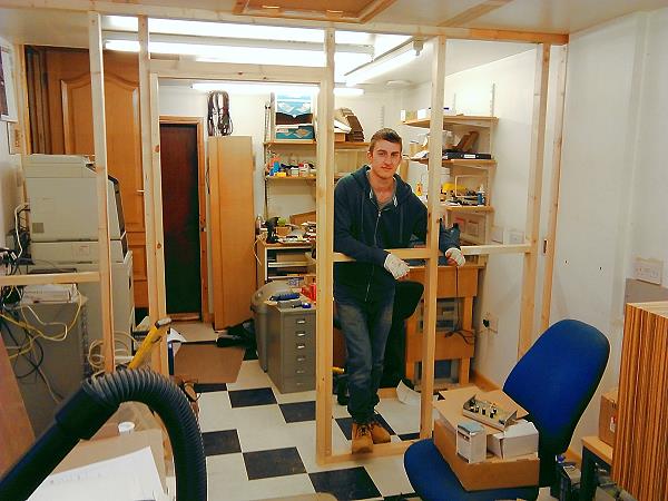

Leaving the packing and printing facilities in situ, the rest was moved into what was the R&D office. The electricians (Darfield Electrical Services) repositioned the lighting, and the partition wall, which was required to make the new R&D office have the right room dimension ratios, was begun.

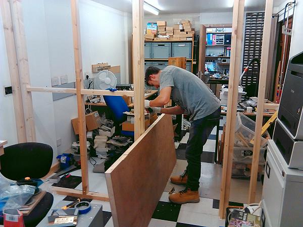

I enlisted "diploma in site joinery" student Ryan Slee, to construct the partition wall (with help from dad...). The studs are proper "3x2" and not CLS which is too flimsy. The door frame also went in at this stage.
And then "the heavy wooden door". Better to use something which won't rattle like those cheap "eggbox" filled doors. This is a half hour rated fire door in the process of being hung. The studs were filled with 50mm rockwool during dry wall cladding. 12.5mm standard plasterboard both sides was used.

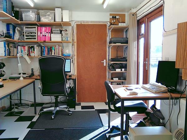

The result: this is the "live" end - the listening position end - the chair swung round and facing you and  positioned in the middle of the mat, gives the "sweet spot". The system rack is furthest away from the speaker end as is practicable - mounted to a dense massy wall section, the 19mm MDF backing is frame bolted to the stone work. This end also serves as general office, prototyping (left) and the CAD PCB artwork design (right). In answer to an earlier question from Richard, yes, there is a window, actually a door and side panel as can be seen (toughened kite marked glass - all 6 pieces - for security and safety). Reflections at this point will be minimal being at 90 degrees to the listening position, and there is a curtain which can be drawn across the glazed area, but the difference between it being open or drawn is difficult to detect. (Pile of muddy shoes under the desk is incidental...)

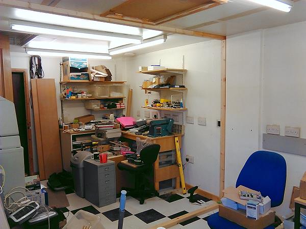

The view from the rack (to the left of the listening position). The unfortunate position of the door is because there was nowhere else to place it, and it couldn't be where the speakers are. The offset meant there was differing amounts of absorption from the stud wall, which is mainly at low bass frequencies. Also there is a pier in the right corner (easier to see in the construction photos), and this, as mentioned before, is dry lining straight onto the stone work. The side walls are dry wall over 50mm rockwool onto single skin stone work to the right, and double skin (cavity) concrete block to the left.
