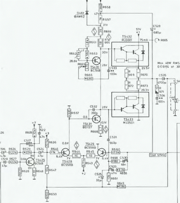

Post Options Post Options   Thanks (0) Thanks(0)   Quote Fatmangolf Quote  Post ReplyReply Direct Link To This Post Posted: 20 Jul 2021 at 5:59pm
Curiously one of my RH544's took longer to go into standby. The timing capacitor read a lot higher, 560uF rather than the 330uF written on it. This is not a new thing but I may solder a 220uF in parallel with the speaker's capacitor to even things out.
Post Options Post Options   Thanks (0) Thanks(0)   Quote Fatmangolf Quote  Post ReplyReply Direct Link To This Post Posted: 21 Jul 2021 at 9:24pm
Of course I could just snip the over-value 330uF capacitor out and solder in a new capacitor of the right value...
Post Options Post Options   Thanks (0) Thanks(0)   Quote Fatmangolf Quote  Post ReplyReply Direct Link To This Post Posted: 22 Jul 2021 at 8:50am
Out of interest here is an example of the amplifier stages inside the RH544:
LF amplifier
