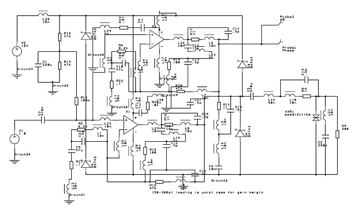

When I'm not sure, I model in all the parasitic behaviours of passive components as well as PCB traces. A resistor isn't pure resistance - high quality metal films are better than most, but they have series inductance and parallel capacitance. Capacitors have series resistance and inductance (at least), and PCB traces have inductance.
What looked like a simple circuit diagram gets very complicated once all those parasitics are included. Here's what it looks like...

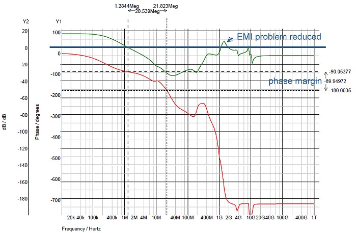

Note that this circuit uses paralleled op-amps increasing output current further - the downside often is that the output tries to rise up in the radio frequency spectrum. This circuit resulted in this plot at the negative feedback nodes.
With no parasitics modelled in it behaved perfectly, but parasitics exist and can't be ignored. The chart above shows a large spike just before 1.5GHz - within the spectrum covered by EMC legislation.
If that spike were to appear at the headphone jack, the headphone cable would do a great job as antenna not only transmitting it, but any airborne frequency between 1GHz and 2GHz would find it easy to get in to the circuit via this output. Here we are talking about harmonics of cellphone transmission frequencies.
Parasitics once identified can be fought with intentional parasitics, small parastic capacitances can be shunted with real capacitors - but as they have their own parasitic inductance, it isn't a perfect cure. In fact there are no perfect cures - parastics make circuit calculations so complicated that it has to end up as trial and error, and that's where powereful spice simulation becomes a great help.
This is the circuit modelled with intentional parasitics plus the addition of an output inductor - an RF choke with enclosed magnetic field, otherwise that would transmit too - making matters worse.
At the feedback node it can now be seen that the EMI (parasitic interference) problem is reduced, but not cured - it is still in the gain area (above the blue line).
Although it is reduced, we cannot allow that onto the headphone cable - it would transmit.
However, I said I'd used an output inductor, and that attenuates the parasitic interference to a degree that might well pass EMC requirements. Probing at the ouput after the inductor it's 60dB below the designed output, and around 44dB (down by 160 times) below the "0dB" reference.
So that should be fine? Well, not exactly. I wanted this design to be small to fit inside a preamp - on the same board. The spike is still there before the output inductor and could transmit to the preamp stage inside the box. Will it cause a problem? The only way to find that out is to build the entire thing and try it.
