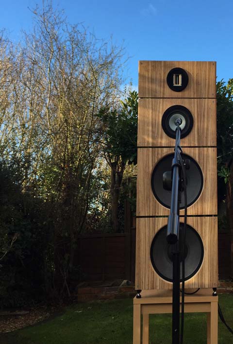

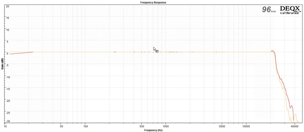

Post Options Post Options   Thanks (0) Thanks(0)   Quote Drewan77 Quote  Post ReplyReply Direct Link To This Post Posted: 29 Nov 2017 at 8:35pm
I mentioned in an earlier post that I may replace the Alpair 7s with the Neo 3 ribbons.
After listening to music over an extended period, the response of the Alpairs didn't quite match my memory of the Neo's (which I had used in the previous OBs for several years). With vinyl, the astonishing & delicate percussion sparkle which I was used to via the Accession was missing so I bit the bullet and decided to change things.
Initially I planned to take outdoor calibration measurements on a dry day last week but by the time everything was set up in the garden, it had become too windy to get a clean response, even using 36 frequency sweeps per speaker (about 2 minutes) which averages out all rogue sounds like occasional birds/distant aircraft/exasperated wife etc. The wind became almost gale force by midday when I was ready so I abandoned that.
I set it up again yesterday, which was dry and wind free - with the added bonus that this followed several days of continuous rain, meaning the lawn was soft & wet, reducing possible floor reflections even though the speakers/mic were raised well above it.
Twittering birds are scarce at this time of year too & I must say that the results were by far the cleanest I have taken. After letting DEQX do its thing 0hz - 20k with frequency, phase, crossovers, group delay and impulse, a second set of verification measurements gave the 'semi-anechoic' response below. This is genuine, not a fake! The Neo's are powered by a pair of Proprius at 3024hz/300dB to the Apair 12s & because the speaker is measured as a 3 way, the interface is corrected automatically and seamlessly. Proprius & ribbons seem like a real marriage made in heaven.
It's not just about measurements of course so this afternoon I started to listen to a selection of LPs and CDs. It sounds marvellous so far, the sparkle is back and the system really does sound remarkable.
