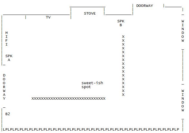

OK so here's another bright idea to betray my lack of understanding of electronics and acoustics (at least), but here goes.
As I mentioned in another thread, I have to live with a rather sub-optimal arrangement of my main system, which consists of various sources into Roksan Caspian M2 and PMC GB1s. I have no choice but to set it up in the living room, where a combination of doorways, windows, frequently-used stove, and even-more-frequently-used TV dictate that the speakers are positioned, well, weirdly (and that I get to use them less than I'd like).
Don't trust the dimensions/proportions too much, but this shows the approximate layout. The lines of Xs are sofas. As you can see immediately, the one good thing about the room is that it's quite big (I guess about 20'x15') - not that that solves my problem, but it does allow for all my LPs, and having them in one place is my greatest victory so far!
Anyway the details don't really matter - we could talk about whether in my particular case I should do X or Y, but frankly there are no options that position the speakers such that they are well placed acoustically AND have a seat facing them! They sounded great on either side of the doorway on the left of the diagram (a speaker at position B2 and one at SPK A), but only whilst I moved the sofa out of the way. So we're back to having one at SPK A and one at SPK B. As you'd expect the result is not brilliant for the sound stage. There is a sweet spot where it is approximately balanced, but the depth of the stage and the clarity of the distribution of instruments is not like it was when the speakers were around the doorway. I want to fix this. I have read with great interest DaveG's thread (http://audio-forum.gspaudio.co.uk/room-treatment_topic2872_page1.html) and the links suggested there, and would be interested in trying some room treatment - people don't seem to discuss layouts that are asymmetric quite like mine but there are doubtless gains to be had. But I don't think that would be a complete solution anyway.

Hi would it work having the left hand speaker between what is shown on the top wall to the left of the tv?   Have never tried speakers on adjoining walls but this may give better perspective on bottom sofa at expense of the vertical one?

Richard, it's a good thought. Actually until recently that was the  layout, although it meant the hifi was pretty much in front of the speaker. We got some new units that allowed me to change this and, by moving the left speaker out of the corner, the overall balance improved even though it meant it was closer to the bottom sofa. A bit counter-intuitive perhaps, but maybe also helped by the fact that the speaker has an opening to the left to further reduce reflections. In the end you're probably right in that I should keep exerimenting with positioning and I may make progress.

Could you put the speakers at each end of the X's and the sofa out from the left hand wall? That would give some symmetry, including a triangular arrangement between speakers and the listening point.
