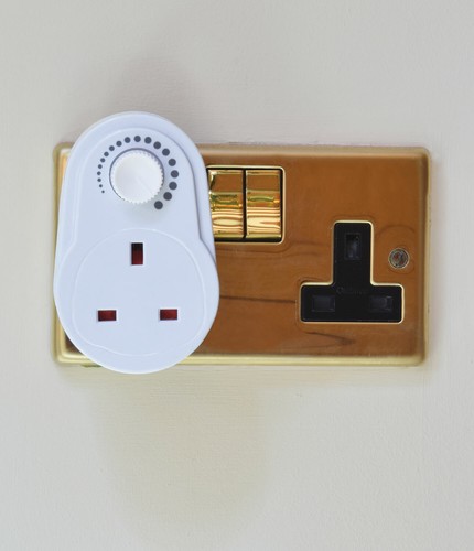

Plug-in lamp dimmers on the same ring as hifi can induce noise.
Plug-in Adjustable Dimmer Switch for Home Lamps | eBay

Thanks. I don’t have ring circuits. My HiFi is on a dedicated line, but it all feeds back to the same place….
