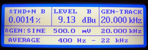

The clever or the dumb can obtain fantastic total harmonic distortion figures using the Audio Precision ATS-1 audio test set:
Take a look at the above reading from a Solo SRGII - fantastic isn't it? Only 0.0014% distortion!
Take another look and you'll see I measured it at 20kHz - wow! Everybody knows distortion gets really bad the higher in frequency you go, so the Solo SRGII must have incredibly low distortion at the customary 1kHz!
It's only when you understand that total harmonic distortion is the measure of harmonics and the first one appears at 40kHz (twice the 20kHz frequency and therefore often referred to as second or even order harmonic), then you take a look at the bottom line of the readout and realise where I cheated - yes I cheated. I stuck the high frequency filter in at 22kHz!
Like I said, the clever or the dumb can obtain fantastic distortion figures Wink

If the 0.0014% isn't a measure of distortion then surely the meter should have read absolute zero instead of 0.0014%?
So what is that 0.0014%? Firstly please understand that nothing is perfect here on planet earth - well certainly nothing man makes!
Let's assume the 22kHz high frequency filter (sometimes called a low-pass filter or LPF) IS perfect, so the 0.0014% consists of no harmonics and no residual signal, therefore what's left must be noise.
The abbreviation of noise is the capital letter N. Therefore the 0.0014% must be N. But noise is usually represented in decibels (minus decibels). I know the noise figure of the SRGII is -84dB which is 1/15,848 or in percentage terms 0.0063%, so is this a miracle SRGII?
Let's take a look at the meters bottom line again. There's a lower filter point of 400Hz, but when we measure noise we measure from 20 or 22Hz to 22kHz, so we have the lower end of the noise missing, and that's why the reading is only 0.0014% instead of 0.0063%. For those who like to know about these things, low frequency noise is more dominant and here we've filtered it out, so we're only reading the noise above 400Hz.

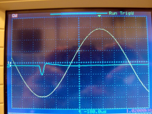

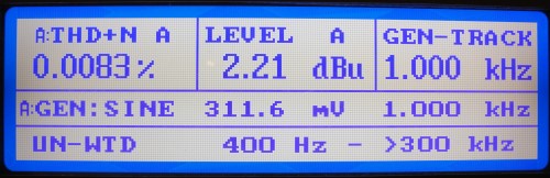

If you turn the Solo SRGII volume control to maximum and measure it as if it were a power amplifier into 32 Ohms, just below clipping the THD+N reads 0.0083% (far better than what we publish) and the evidence is provided in the scope and meter photos below. Actually this is a bit more than the stated 27mW into 32 Ohms - we always like to be on the safe side (2.21dBu = 0.9995435074mV, and that squared and divided by 32 = 31.22mW) .

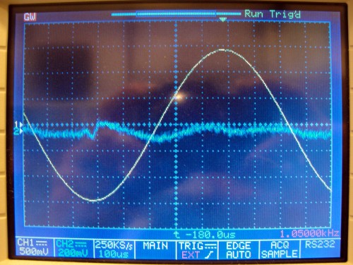

However, if the input signal level is carefully tweaked to give just the required amount of clipping until the meter reads 0.06% you will obviously get 0.06% as I did below...
You will also see that the sine wave is actually just clipping and therefore is not just below clipping. The clever or the dumb can indeed also obtain any reading they like, but to achieve the above I must congratulate the challenger in being of the clever variety.
