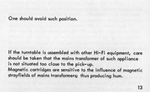

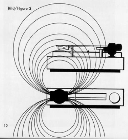

Browsing the said site I came across a manual for my TD125. It had a very interesting page for those who report hum, so I copied the diagram and it's below...

Adding to Adrian's excellent point about magnetic induction I would add that tape recorders (and VCR's if anyone else still has one) and anything with a magnetic hard disk e.g. a Sky+ box will not benefit from being on top of hifi gear with a transformer in it. You may experience distortion or dropouts.
