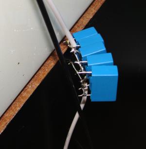

I disconnected the Leak tweeter and put the Usher 520's on top wired with a simple crossover cap to make them into the mid and tweeter section (wow! a three way system!), the Leaks handling the lows up to 1200Hz where their own crossover cuts.

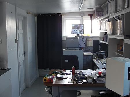

This is my back wall in answer to Fatmangolf.

Thanks for the picture Graham, I appreciate it sounded like a weird question! I can see why you've gone for nearfield, and why that made the poor crossover parts tiresome.
