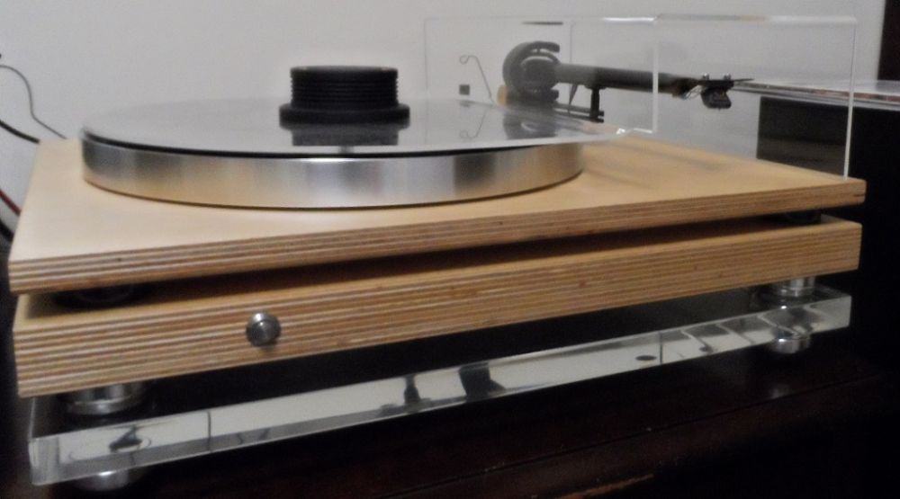

I know it's odd to post a reply to such an old post but I thought it was the ideal place to show the forum a picture of my own DIY turntable. A defunct L*nn Axis was the donor for the bearing, inner & outer platters. The motor was from a retired LP12, the Project 9cc was off of Ebay ( as was the power supply ), and the Goldring G1042 came to me via Gumtree where some bloke didn't like the sound of it.
The idea(s) behind my design were isolation, isolation, isolation, the 20mm thick acrylic plinth rest on aluminium feet placed on top of sorbothane hemispheres. The main plinth 35mm Baltic birch ply holds the motor and the power supply. The top plinth holds the bearing and arm is 12mm think and separated from the motor plinth by 10mm think sorbothane washers.
Great experience, would recommend anyone have a go at there own.
Post Options Post Options   Thanks (0) Thanks(0)   Quote Richardl60 Quote  Post ReplyReply Direct Link To This Post Posted: 17 Feb 2019 at 10:24pm
Looking good!
