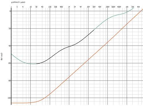

To supplement my last post I include illustrations of passive RIAA stages.
passive riaa eq block diagram
A block diagram illustrating the basic workings of a dual gain-stage with passive RIAA EQ.
The original RCA design with R's and C's transposed.

The way to make "clicks and pops" not so noticeable is to give the 1st stage of amplification more headroom for 50% to 70% of the loudest expected "clicks and pops".
 (50% to 70% of the loudest expected "clicks and pops" would be those that are tolerable and not be disruptive to the audio.)
 The 1st stage has to negotiate the rising frequency response of the magnetic cartridge and
the frequency response of RIAA shown below...
 At 20kHz it is 20dB louder than at 1kHz. That needs to be reduced in the 1st stage.
If the 1st stage of amplification cannot receive the higher frequencies with enough headroom, the sound will get very distorted.
 Graham likes to use 14dB or more headroom above the loudest expected musical peaks...
This keeps the signal very far from ever "topping out" or clipping.
 This also reduces the noticeability of "clicks and pops".
 The 1st stage of amplification must have some frequency equalization for the headroom to exist.
As RIAA curve shown below... (from one of Graham's designs.)
 the frequency response shows 40+dB gain spread from 20Hz to 20kHz.
 Follow the black section of the green trace... The red trace shows where the "theoretical" headroom is.
 (The actual headroom may be + or - 6dB from the red trace due to real parts interactions.)
At any frequency on the graph, the headroom red line is more than 14dB above the black.
The phono stage needs to give the bass a boost of almost 20dB and the treble a reduction of almost 20dB, both with respect to 1kHz.
 A MM phono stage with a gain of 41dB would have:
 41dB @ 1kHz,
 61dB gain @ 20Hz,
 21dB gain @ 20kHz.
 Adding 14dB headroom would give extra voltage above that needed to amplify those amounts.
If the 1st stage is not frequency equalized, it is almost impossible to get the headroom needed.
 The above explanation is including knowledge gained from Graham Slee's many tutorials, but I have learned these facts presented here to be true over the past 50 years of my own experience in electronics design and maintenance.
 Graham, don't stop being a promoter of great sounding audio designs.

Hey! Great find, Bruce!
Excuse me for flipping the image. That bendy curve is just what I was looking for.
inverse RIAA
You see, that bendy curve is the amplitude of what comes out of a magnetic cartridge playing an RIAA record.
Rather than bend your head upside down, note the 1kHz position from Bruce's post, and now note that at 20kHz, the signal is 20dB (ten-times) bigger.
Should you buy a passive phono with a 20dB clip margin at 1kHz, it has no margin at 20kHz.
At 20kHz, it has plenty of distortion, however. Near clipping, distortion increases rapidly. Perhaps it would need to come down a bit?
The best headroom we got for the BBC radio desks was 26dB (but they never played vinyl on them). I know we'd have had to go for discrete circuitry to get more, as with op-amps, the power supply was a maximum of 36 volts.
Now, on that inner groove, the nips and tucks are tighter, and the excursions need to be larger to keep the same relative level.
The best of styli do break rank just a little, and so the highs might-well get a tad higher because this is where the mechanical distortion is at its worst.
If there's no clip margin, the distortion is 100% where the stylus breaks rank, so you'll need at least 26dB, which requires a 200mV max input!
But what about the hairline scratch? What about the micro-bubbles due to stamping a hot dollop of vinyl? If those bend the cantilever that tiny bit further, the output increases.
When that input stage clips, negative feedback ceases to work, and the gain zooms up to its open-loop value. That compounds the click - it lengthens it. What would have gone unnoticed because of its equivalent high-frequency is now reduced in frequency because its effect is extended in time.
To prevent that happening requires a lot more input latitude than 200mV, requiring a high voltage power supply of 90 volts or higher. I think Technics used 126 volts on a phono preamp (I'd have to check).
Now, if you go to Audio Science Review, you'll see they understand what I've said above, but they have no understanding of active EQ. The clip margin on active EQ follows the curve, so if it's quoted as 46mV at 1kHz, you multiply it by 10 to get the clip margin at 20kHz - which is 460mV.
To get a 460mV clip margin out of a passive either requires a massive supply voltage or much-reduced input stage gain. The latter is a no-no for the signal to noise.
What helps the passive, however, is its RIAA filter. Being passive (as per its description), it applies the equivalent of a scratch filter, which rounds off the clip's sharp edges. It is the same method used in synthesizing a sine wave from a square wave in hardware circuitry, except it only has one stage of filtering, so it isn't fully disguised.
However, it does add hash, or as the audiophile reviewers called it - detail.

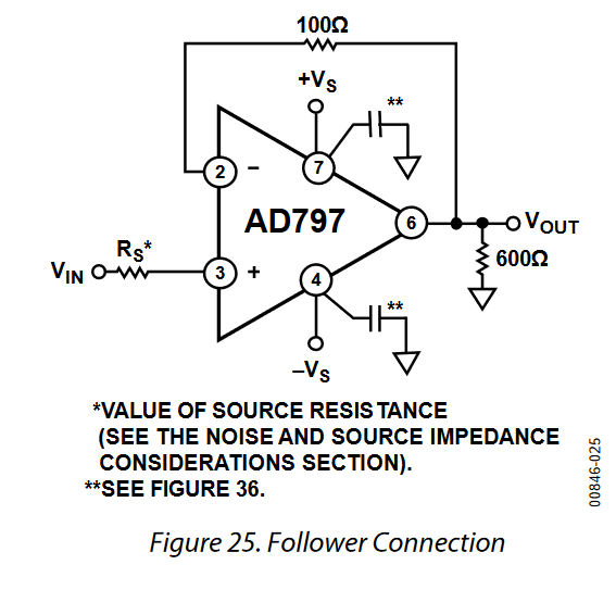

Refering to Art of Electronics 7.07, we find input slew-rate depends on how much voltage swing the input can take before its overload must be passed to the next stage. The next stage must feature compensation to rid excess phase which would result in instability. Once input overload is exceeded the input drives the compensation capacitor, and so there is a step change between the intended input impedance and the lower impedance of the next stage in parallel with the capacitive load.
A silicon transistor has a 60mV peak linear "portion" and should the input stage be differential, which it is in the case of an opamp, the maximum rms voltage is 42mV.
This can be agued away by saying that negative feedback increases the input latitude, but if it is assumed the negative feedback has failed to function in time due to propagation delays, then the 42mV stands. If the cartridge outputs 4.2mV at 1kHz, it is 42mV at 20kHz. There is no headroom.
Section 7.07 also derives an input stage slew rate formula, which is 0.3 x Ft, and using a common low noise opamp for phono stage use, the AD797, we find it's stable Ft is 30MHz. It's input slew rate must therefore be 0.3 x 30 = 9V/uS. It is advertised as 20V/uS, but that is its output slew rate. It is obvious therefore that it has slew rate enhancement, and that never sounds good, because to do it, the input stage must clip.
The low noise ability of the AD797 is hampered by the requirement of an input resistor to prevent instability.
Here are the datasheet takeaways.
AD797 inside
The internal circuit shows the input stage emitters joined together supporting the 42mV finding.
bode plot
The Open-Loop Gain and Phase Margin vs. Frequency graph shows the double kink of the phase response which illustrates the change from input slew rate to output slew rate. This is coupled with the expected "dive" in fall off rate from 1MHz to approx. 3MHz (the difference between 20V/uS and 9V/uS). It also shows that Rs* must be used or the phase margin shrinks to less than unity.
Source resistance
The resistor Rs* adds input noise above the claimed 0.9nV by square root of frequency range. 1k adds 4nV.
