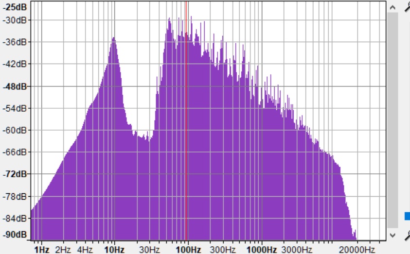

Never been one to take anything for granted, I had a friend lend me his Prestige Gold 2 for a while...
So, following my previous report ( https://www.hifisystemcomponents.com/forum/2m-black-at440mla-mp500-setting-and-comparison_topic4661.html - https://www.hifisystemcomponents.com/forum/2m-black-at440mla-mp500-setting-and-comparison_topic4661.html ), I decided to put it under the same scrutiny on my Technics 1210 Mk2 + Reflex M + Solo Ultra Linear DE... Hoping as usual to be of use to other forum members!
Grado Prestige Gold 2
VTF: 1.6 g
Antiskate: 1.7
VTA: 1 (but take into account that I use a thinner mat than the stock one: those with the 6mm mat will probably want to dial 3)
Surprise, surprise...
- it hums a little bit, yes, when the arm is very near the runout groove. But I can hear it faintly only when there is no music playing, and with the Solo at 4 o'clock position with my rather sensitive (98 db/mW) headphones. I wonder why Grado doesn't shield their cartridges, but to me the hum is so low that it won't be a deal breaker AT ALL
- it is a very nice tracker, at least comparable if not even BETTER than the Ortofon 2M Black/Bronze: I get the "bee" (in both channels) only in the most extreme torture track (300Hz at +18dB), and in all other tests it's flawless
- the resonance tests show some evident oscillation in the horizontal test at around 9 Hz (with even a hint of incoming mistracking), and some oscillation at around 11 Hz vertically. While the oscillation is stronger than with my other cartridges, it remains in a "safe" frequency range so it's not a reason to worry (and with a lighter arm it could even be less a reason to)
- sound is rich, chewy, but not fat or bloated. High frequency detail is there, simply not as glaring or "in your face" as for the example with the Ortofons. To me the sound is somehow reminiscent of the one I get from the Nagaoka MP-500, maybe slightly thicker but not in an unpleasant way at all
- surface noise is quite low, again very satisfied from this point of view too
I must say that I am actually pleasantly surprised by this cartridge which doesn't cost an arm and a leg, and even more pleased to see that my fears were unfounded. Planning to listen to it a few more days before returning it to its legitimate owner: if I didn't already have three cartridges, I might consider adding one to my collection.

Very interesting again. Not faithful sounds about right. The FR graphs I have seen of Grado cartridges often show a pronounced dip in the upper midrange.
Here is Miller Audio Research's FR vs. Separation graph for the Gold 1. No idea if the current "Gold 2" is similar or completely different.

Date Posted: 21 Apr 2023 at 10:02am
I re-tested the resonance: after all, since my initial tests, 100 more hours of use have passed, and the suspension has got looser.
Horizontal test: the new stylus oscillated at 9 Hz, now it oscillates between 7 and 11 hz, and the oscillation at 9 Hz is very strong.
Vertical test: the resonance peak was at 11 hz, now it seems to have gone higher, around 13-14 Hz.
13-14 Hz starts to be near the critical zone, I guess, which probably explains the audible behaviour I met with the Sinatra record.

Are you able to make a short digital recording - directly from the phono stage? At any rate, I still think the KAB damper could be worth trying (I have one), though I can't guarantee it will fix this specific issue with the Sinatra record. In general it should improve the tracking of most cartridges, but particularly those that are rated at 20CU compliance and higher.

My PC is a tower workstation, I would need to move it near the turntable. After this long holiday (it's end of WW2 festivities in Italy), I will do it!

Enjoy the holiday. All you need to do is record approximately 1 minute or a little less of ordinary music. Just make the sure the record is flat and well-centered. From there we can look at what the cartridge is doing in software.
Posted By: Lucabeer
Date Posted: 21 Apr 2023 at 10:59pm
Oh boy, I recorded that track with the Grado...
https://drive.google.com/file/d/1A616Ge4pnRFOqY2qRizBDZkVhdJMxabu/view?usp=share_link - https://drive.google.com/file/d/1A616Ge4pnRFOqY2qRizBDZkVhdJMxabu/view?usp=share_link
Look at the resonance!

Curiously the peak is still there, and now that I'm listening carefully I hear the bass pulsation here too... I had never really noticed it! But it seems to me it's less evident than on the Grado, and the cartridge is not visually "dancing"...

So, ultimately, it seems that the resonant frequency is at 10 Hz anyway... both with the Grado and the AT. 10 Hz is considered to be the "perfect" frequency for cartridge/arm matching, so I shouldn't complain... And it's at 10 Hz both with a slightly warped LP and a flat one.
The only thing that triggered the alarm was seeing the Grado cantilever bobbing up and down with the slightly warped one.
But as I re-checked... It's very audible with the AT too.
Anyway, this exercise confirmed my impression: that the Grado has more high frequencies roll-off! And that also explains its "warmer" sound.
Date Posted: 22 Apr 2023 at 12:10am
I don't think the problem with your Grado is tonearm matching. It's just that particular record is tough on the Grado and Grados have suspensions with less damping than some other brands of cartridges. I'd be curious how the Grado performs with the tonearm damper installed.
Date Posted: 22 Apr 2023 at 12:20am

Normally we would use an accurate test LP for this kind of comparison, but you can see what your track looks like here. The files are level matched and the Grado file needed to be brought up 1.8dB relative to the AT file. The AT file has +3dB at 10K relative to the Grado. It may be that neither cartridge is really neutral - I know from experience that the AT 4 coil models are difficult to optimize with generic MM loading. My daily driver AT is loaded at 36K + 180pf, for example.
Posted By: Lucabeer
Date Posted: 22 Apr 2023 at 7:55am
I was quite surprised to see how huge the infrasonic content is, though, even on a flat record and even if it's inaudible!
Wouldn't that be energy "wasted" for nothing, from a purely physical/electrical point of view?
Is that the reason some use a rumble filter in their amp?
About the loading of the AT... well, I have never had anything to complain about with the standard loading on the Reflex M (47K + 100 pF). Probably my Technics tonearm cables (it was recabled years ago) have a low capacitance. Never heard the excessive brightness some experience, and my hearing is still good up to 18 kHz (recently tested).
From the spectral analysis, the Grado has a surprisingly extended high frequency response (above 20 kHz) for being a simple elliptical. But still, that 3 dB difference in favour of the AT in the highest AUDIBLE frequencies (10 - 16 kHz) shows why I like the Grado with mellow acoustic music, and the AT with rock.

Yes I agree that's why there are rumble switches for high pass filters or fixed filters taking off infra-bass below 20 Hz. Otherwise a lot of amp watts are used and woofer cones can dance, especially in ported/reflex cabinets. Personally I'd prefer seeing some cone movement to hearing a steep sloping electronic filter.

I think where some people run into issues with LF content is when their turntable is not well isolated and the speakers are not well place, and they are playing records at high enough volume to generate a LF feedback loop that causes nasty distortion or makes the stylus jump. IIRC gross mismatches between the cart and arm (not that common anymore, but possible) can also cause big problems.
I used to use a set of plug-in rumble filters with my phono stages but after getting the Reflex M and reading about Graham's reasoning for not including a rumble filter, I took those filters out of my system and haven't used them for almost 4 years. There is no negative effect that I can discern, at least not at my listening volumes. I should also mention that I listen with my speaker grills on, not off, so I am not obsessing over woofer movement. I think a lot of people are paranoid about damaging their speakers or something with LF content, or causing the amp to "work too hard" or some such. Not an issue on my end. I have never, ever had my amp go into protection mode or get hot or anything like that from not running a rumble filter.
RE: AT carts, I used a CBS test record and software to optimize the FR. Without loading down to 36K using loading plugs, there is too much peaking at the high end. My 1200 (new model) also has RCA jacks and low capacitance cabling. Subjectively it sounds better this way as well, IMHO. Note this is only for the 4 coil models with aluminum cantilevers and the ML stylus. The 2 coil designs (VM95/AT95) can use a generic load of 250pf (total, including cables) and 47K and have a very nice response.
Posted By: Mikeh
Date Posted: 22 Apr 2023 at 2:38pm
The spectrum analysis graphs are exactly how I have measured the tonearm resonance and compatibility with different cartridge/headshell combinations.  When I first noticed this effect, I had similar thoughts, there must be something wrong, all that 'lost energy'. But no, further research showed this is absolutely normal.  Peaking at 10Hz is normally considered  a perfect match, the recommendation being 8-12Hz (as I have read). Nothing wrong with this at all.
I can say that I tried reducing the peak with a rumble filter (KAB) or a tonearm damper but have removed both.  The rumble filter made no audible difference (to me) and Graham's previous comments about filter effects made me re-think. A tonearm damper can help shift the resonance frequency but not reduce it's amplitude.  I have read comments somewhere that many amps are designed to apply low frequency filters so the infrasonic signal is removed before reaching the speakers.  Can't say if this is true but might be worth looking into for your system.

From an engineering point of view, adding a low frequencies filter is a big "no" for me. It means introducing a "zero" around 20 Hz (to have an effect on 10 Hz), so it would also have a bad effect (attenuation and phase shift) on audible frequencies up to 100 Hz.
Better survive with the 10 Hz resonance peak!
