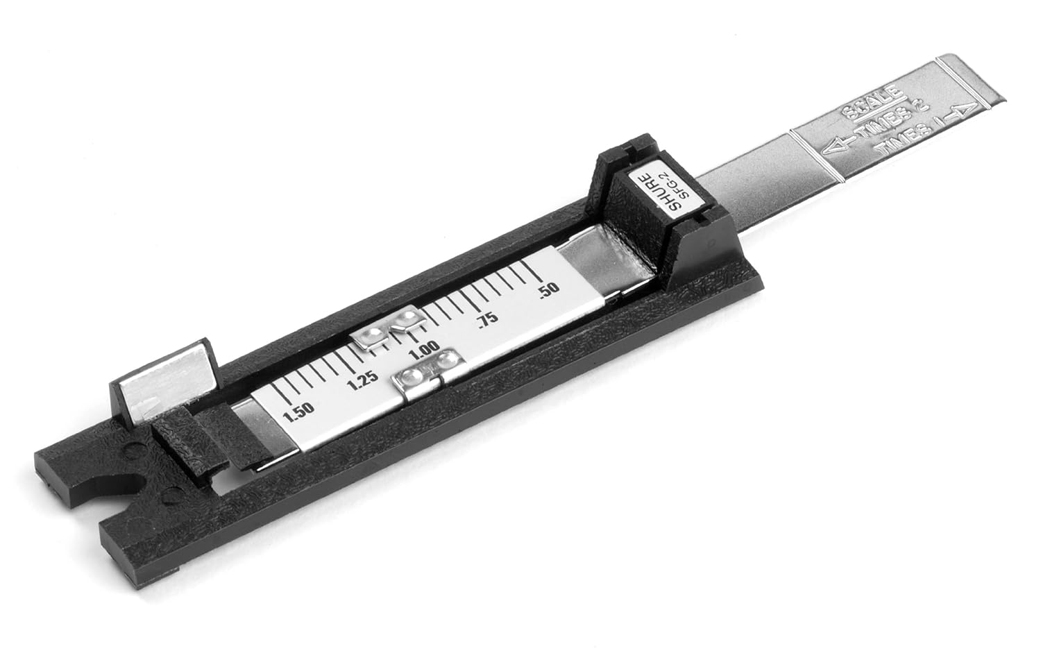

Ideally VTF should be set with a balance or scales, so cueing arm down.
I have one of these
one of these
and one of these, which gets used most of the time.

Agree about using scales rather than 'hover 1mm above record and set zero on weight dial.' But a tip I'd offer from early experiences is make sure the headshell/cartridge is level seen from the side when measuring VTF, i.e. same as playing a record. Any of the good scales Chris suggests will be thicker than a standard LP so take the felt matt off (if applicable) and put the scales on the platter.

What happens when you reduce the tracking to within Ortofon's recommended range, according to the digital scales?
I haven't used the built in stuff on tonearms for years.
I have a couple of stylus balances (cheap and cheerful Ortofon, and a Shure SFG-2), and now a digital readout job from Ebay, and I'd trust what any one of them tells me before I'd trust the calibration marks on a tonearm.
The only tonearm manufacturer's markings I'd trust are the one's on SME arms - the old man was a stickler for things actually working as defined.
