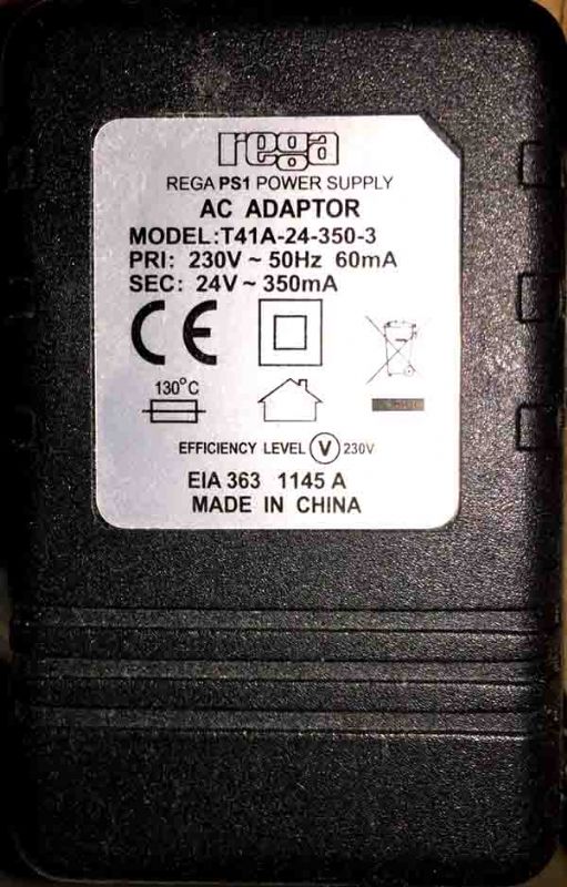

This is what I am asking about - a replacement for the wall-wort that supplies 24v to the Rega TT-PSU:
It plugs into the rear of the TT-PSU using one of these:
Date Posted: 24 Jul 2015 at 9:16am
The label says it has a 50Hz input which is the mains frequency common to all UK mains supplies (and is 50Hz in many other countries using 220-250 volts)
It doesn't state the output frequency, but if it is just a transformer inside then its output will still be 50Hz.
The voltage is stated as 24. It has a squiggle after it that means it is AC (alternating current - just like the mains is). If it were a different frequency safety rules say the frequency should be stated.
It also shows the current rating which is 350mA, and that should be taken as meaning the maximum safe current that can be "drawn".
To me it looks just like any other OEM plug-top transformer badged up at no extra cost if you order sufficient. I once did the same and my guess is it is made by the same Chinese company.
