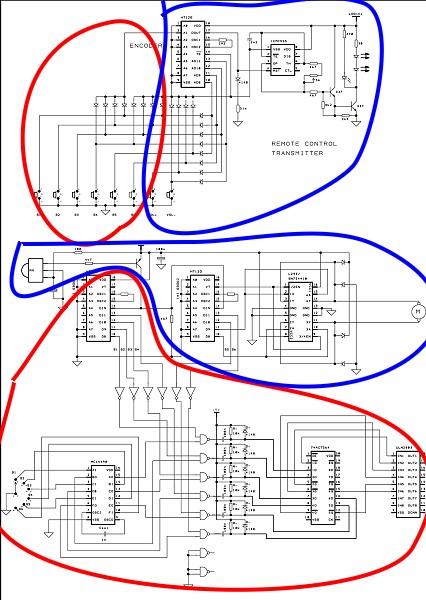

My intention is to make the preamp as a number of low profile cards plugged to a horizontal 'mother board', such that some functions may be included or not included as required by the customer. This may require two or more types of front panel.
This should enable different remote control options to be provided:
1. Manual - no remote control:
Manual operation rotary input selector and manual operation conventional rotary volume control.
2. Semi-manual - remote control operates volume only:
Manual operation rotary input selector and motorised operation conventional rotary volume control (which can be manually operated too).
3. Full remote control - remote control operates volume and input switching:
Hardware-logic operated solid-state input selector (which can also be operated by a similar looking rotary front panel switch to the manual version) and motorised operation conventional rotary volume control (which can be manually operated too).

Graham, this sounds tremendous; an attempt to satisfy almost every persuasion and excellent news if you can do this and still satisfy commercial imperatives. Thumbs Up

Bespoke audio engineering at it's best! I hope it's financially possible. If it is it'd be very interesting to see how the orders are split . . . Ermm

Thank you for the supportive words above.
Until each section is proven to work/perform then nothing can be promised, but that work is taking place.
The discrete gain stage I may have mentioned, has been subjected to further investigation today - mainly to reduce distortion which is now 0.015%, and slew-rate symmetry which is now close to being equal on rising and falling signals.
Compared with opamps the distortion may look a little high, but the discrete stage uses just four bipolar transistors against at least 25 in an equivalent opamp. The design is 'pre-differential' and another of my favourites from my earliest experiments in audio electronics (late 70's). I am attempting to do as much as is possible in the preamp with discretes, but will not sacrifice performance if an opamp can make a better sound.

Date Posted: 01 Jul 2014 at 10:29pm
Progress on the remote logic...
Remote Control Logic Circuit
The sections outlined in blue are the easy bit - the motorised pot volume control.
The sections in red are for the input selection and there are no relays drawn in yet.
The upper sections are the handset. The lower sections are the decoder and onboard control logic.
Rather than use push buttons for manual input selection I'm using a 'clever' rotary control similar to what you sometimes find on Japanese amps: these are constant rotation switches which behave like conventional rotary input selectors but have no markings and instead use LEDs to indicate the selected channel/where they are. The rotary selector and remote control selector interface with each other to operate a solid state version of a mechanical interlocking switch bank.
In the end I have chosen to use relay signal switching as I want to include a record-out selector as per my original plan. All other ways proclude that because of the load placed on the inputs. I have found a suitable type of relay which will do dry circuit switching reliably provided I include some protection against inadvertent connection of high voltages and large DC offsets at the inputs, which would arc the contacts and once that happens the contacts are no longer any good for dry circuit switching. I am having to import the Japanese made relays from the USA because we have little of much good in the UK anymore.
Although the logic looks quite complex, provided it is reliable I don't mind. I also prefer to do it all in hardware rather than trying to program PICs in production. Obviously the eventual finished circuit will be tested in all manner of ways to ensure it never interferes with the all important music signal.

Pleased you having fun - it looks like hieroglyphics to me! ;-)

Date Posted: 04 Jul 2014 at 5:20pm
Originally posted by Bi-wire Bi-wire wrote:
I don't pretend to understand it all...
And I don't pretend to understand all of it either Wink
Negative logic eh? What's the point! Confused
Negative logic is just positive logic upside down... sometimes it is easier to process logic by pulling a "1" down to ground than up to positive voltage. The positive "1" is then restored to positive using an  inverter (a Schmidt trigger version would then be used to resist glitches from false triggering the inverter).
I worked with "9's compliment" BCD logic in security applications, it is similar to octal BCD.
Negative logic is: "1" is represented by a zero and "0" is represented by a one... upside down!
Date Posted: 04 Jul 2014 at 8:48pm
Graham wrote: "The sections outlined in blue are the easy bit - the motorised pot volume control."
I would be happy with just that plus a remote mute.
Manual input selection is logical because most times I would be at the equipment changing a record or FM station or CD.

Yes, but we'd invert intuitively as a design went along for reasons that not all things we see as logic 1 are actually logic 1 in the real world, as per your example "sometimes it is easier to process logic by pulling a "1" down to ground than up to positive voltage", but we would invert it or use suitable gating, clocking etc, to get the desired outcome.
My question is why we need to invent another load of logic functions, and with it the education required to understand it, to do something we intuitively managed to do so easily with the pre-existing logic families?
I must be missing something? Or the "not" function of that argument would read - they must be missing something? But they'd need negative logic to be able to process that... Confused

To recap, some want remote control of source selection and volume, for which I have a logic circuit design to develop and include.
Some don't want full remote control, and some don't want it at all, but I am limited to the one enclosure size.
