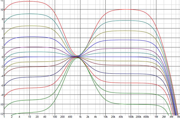

Date Posted: 13 Jan 2013 at 5:16pm
Mike, I was considering 2 (bass and treble) because it only requires one amp stage, whereas mid requires another amp stage to do it properly, but I guess it could be done so-so using one amp stage.
I'll reproduce the plot from an earlier bass and treble tone control I did back in the mists of time (21 years ago)...
I make it around 4dB per octave at maximum boost/cut and much gentler lower down. This tone control was worked out on a calculator from equations which was good enough then. Today, with computer simulation I can reduce the amount of boost and cut and make it more equal. I can also see from zooming in to the set flat positions that it varied less than 0.01dB end to end, and I can also see that a number of commercial high fidelity tone controls were more like 1dB variation, and that could be why people turned away from tone controls even when set to "flat".
